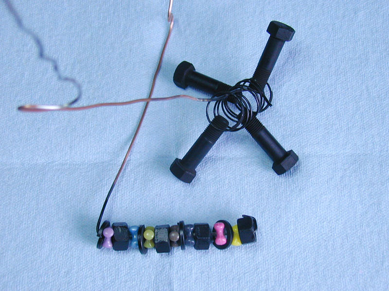

I've tried the basket thing too and it sucked, hard to rinse too. I know you are doing copy cad and this doesn't apply, but the shaker basket isn't worth a **** in the nickel because you temp loose connection with the part and it wont plate well. When I do nuts and bolts, I thread the nuts on a wire with plastic beads in between each one. Bolts, I take a long piece of wire, and wrap once around each bolt on the threaded area usually alternating the direction of the heads for balance. When I'm finished it looks like a string of popcorn.

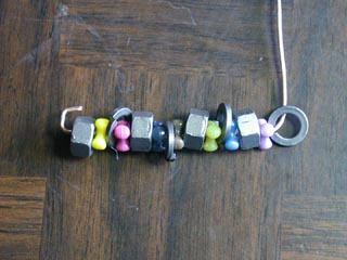

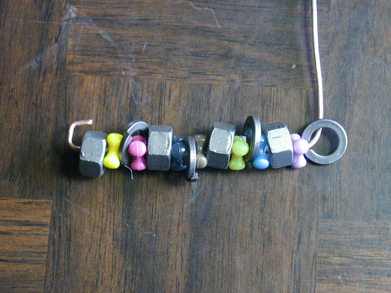

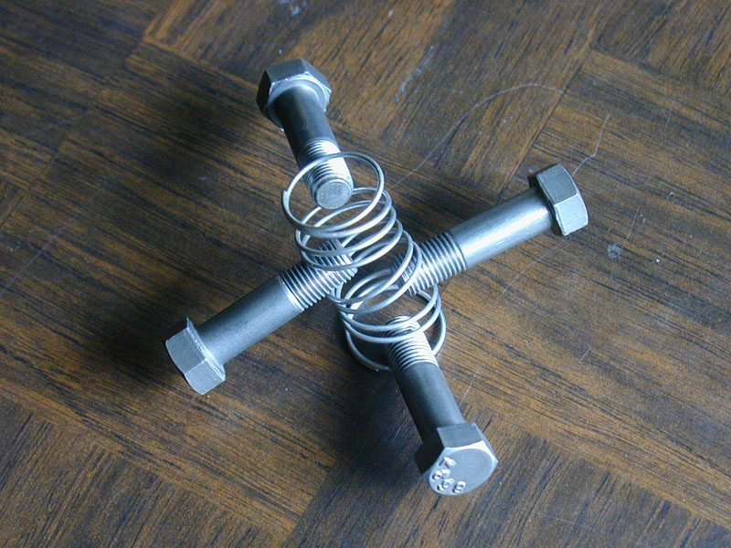

I've done the plastic bead thing too. It works good for small batches of parts.
Wiring up bolts individually is a royal pain though, so I tried a spring "rack", and IT works good too.
See next post. Forum won't let me post more than 2 photos per message.

They all plate just fine:
But it's just too time consuming to do a high parts count this way. For anything more than a small handful, a barrel is the best solution.
