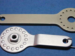

Here's the first sample photos. 55 year old auto parts.
I plated both pieces w/out brightener additive in the electrolyte. The silver piece was nitric acid bright dipped after plating, the grey piece was not.
The second photo shows an original piece w/most of original cad plate remaining. You can see why I chose to bright dip the parts. (click photos to enlarge):
I will be putting more photos up on a web page later today. Will post the link when it's done.
