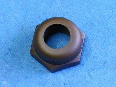

So how long will the black chromate last? It's not possible to say. It just depends on how many square inches of parts you chromate, and how long you leave them in for (and, how much gets used up by contamination).
When I first started to use my black chromate, parts would turn deep black w/in 15-20 seconds. By the time I had the mishap that ruined the chromate, it was taking 30-40 seconds to get deep black. So it was clear to me the chromate was depleting. By this time I had done about 350-500 sq-inches. YMMV.
After the mishap, this is what parts come out like, even after 5 minutes in the chromate!
