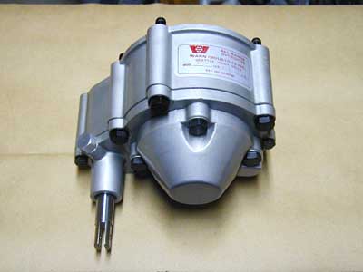

Default Can you clear a fresh blasted alum manifold? I want it to look like a raw casting but
stay clean. It's for a Cobra and I want it to look original without gloss

you can use flat clear.

after you blast it hit it with a wire wheel to knock down the blast profile. it will have that cast look if you don't go crazy with it.

Default Re: Can you clear a fresh blasted alum manifold? I want it to look like a raw casting
blasted then cleared

i use (blasted aluminium finish) powder, it s very close to the look of a freshly blasted aluminium done with new very fine glassbeads .
since caswell does not carry that color i guess i can say that it s from eastwood

Beadblasted, outgassed, coated in Satin Clear (click to enlarge):
