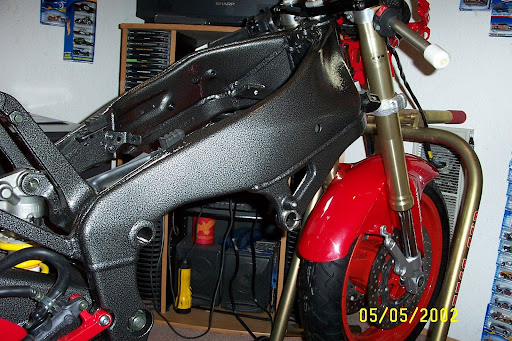

    I've been searching around recently, looking for the difference between the two. And frankly, I really can't tell. Some call it veined, some call it hammertone. I'm just trying to distinguish the difference. Does one hold up better than another? Does one flow out more evenly/smoother? Are they even the same two colors being blended? Here is a picture of what someone calls "hammertone", and another what the guy calls "veined". Two different people so who really knows...
    Hammertone.

    and Veined. Look the same to me

    I've never shot hammertone just silver vein. That pic looks like silver vein when you shoot it hot. If you shoot vein cold it comes out much darker than that and more pronounced veining. Not sure how you shot that hammertone though.
