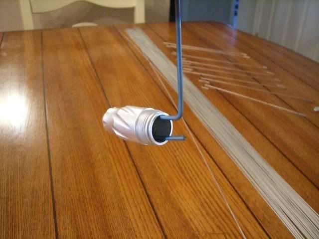

    While the tank was down, I ordered some 1/8in Ti rod from McMaster Carr.
    3ea. 6ft lengths of type 2 rod cost $82, plus shipping. Right after I ordered it, I found it locally at www.onlinemetals.com for half the price.
    I was able to bend it into kind of a U shape to fit into the SS bus bars I use for racking. The bus bars have holes drilled every 2in. both vertically and horizontally so that they intersect. The horizontal hole is tapped, and a SS thumb screw is used to hold the racking wire.
    The business ends of the Ti rods were bent into a modified U that acts as a inside clamp. I made them all the sizes that I need, along with some threaded ends. All for holding paintball gun parts. They work really nice.

                            No, They are simple 1/8in and 1/16in wires bent to form a kind of clamp, then they are suspended from a common SS bus bar.
