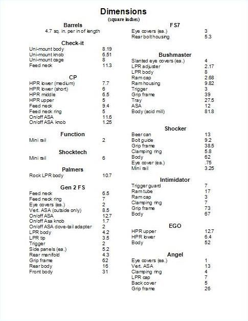

    OK, I'll start this out...
    Please post any common SA dimensions you may have.
    Here is mine. These are paintball gun parts. I''ll add to it as I get more info.
    All dimensions are welcome... not just paintball gun stuff!

    Pic working! you deserve about 100,00,00,00, e cookies!

        acid rain, you should specify what model/ what year part are, because milling changes a bunch from gun to gun, and year to year. If you need any help IDing parts, I have a pretty good knolage of paintball guns, and could help you out.

          Hmmm... moved my pic, and tried to edit my post, but can't figure that out. Am I missing something?
          I'll work on the model/year info, and I have more to add (when I can).
          As for the on/off... all on/offs come apart. Usually they unscrew (with heat to break the loc-tite), but I believe on the EGO, the pin is pressed in.
          Here is the pic again:
