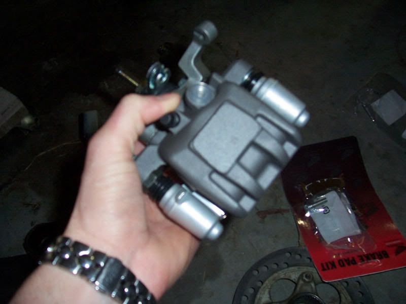

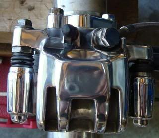

    Hey all, i've been reading these forums for a while and only been polishing for a few weeks now. Just thought I'd post a few pictures of my latetst work and wanted to ask a few questions about the process.
    Started with this
    Now it looks like this...

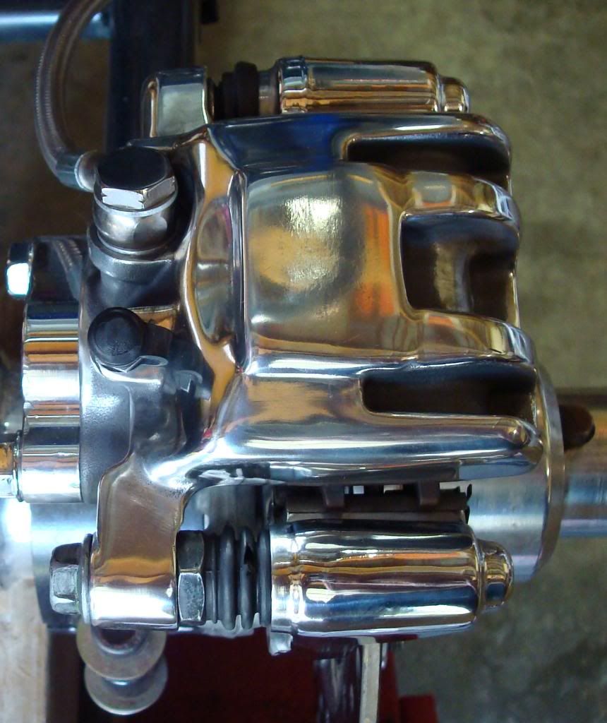

    I went to 600 on the top of the part and then to black/spiral, cleaned, brown/spiral, cleaned, then green/spiral...I can't seem to get the part free of waves after sanding smooth...any ideas?
    It looks like orange peel...what causes that?

      what did you use to sand it with? paper, greaseless, machines?
      uneven surfaces sandng with greaseless on a mop can be one cause

        I'm guessing greaseless. You need to use white compound with that to prevent the orangepeel.

            Looks good, I did the same to my 310. Sand allot more before you go to the polish. Need to get it flat with sanding or grinding before going finer, I usally go down to at least 1000 grit. The polishing part is only about 10-20% of the process. Where do you ride? I usually go to Little Sahara in Oklahoma.

              I sanded the surface with some surface prep disks from harbor freight, I can't seem to find the item online but I used a die grinder with 150 and 240 grit disks and it took all of the casting marks out easily. You can see on the caliper bracket that it is really shiny...and all I did was sand with those two disks and then start with emery/spiral; tripoli/spiral; green/loose cotton
              On the caliper itself, I also used the two disks, then wetsanded to 600 then used emery/spiral; tripoli/spiral; and green/loose cotton...can't seem to get those marks to go away...

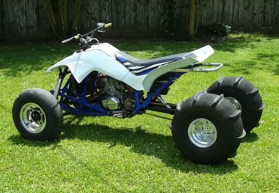

              We only ride here in louisiana at a small dune recreation area...heres a pic of my 310
              Lookin to upgrade to a 370!

                    Your curve areas look good. If you have a da sander use it on the flat areas. I use the da with different sandpaper, lubricated with wd40. Make sure the sandpaper doesn't get any debris or build up or it will leave little swirls. Harbor freight sales little 3" polisher and sanders for around $30 to $40 dollars that work great. 3M makes a full line of 3" Velcro bake sandpaper. Now take on the cylinder.

                            I use both of them I use the second one to rough it in with sand paper and with 3m Scotch -Brite Roloc surface Conditioning disc. They come in different grits but work great. The first one,the da, I used with sandpaper to get the super flat finish for a deep shine and wd40 . You will be surprise how little you need to use your buffing wheels and polish if you do the right amount of sanding to a fine finish. I usually sand out to at 1200 grit. If you do the sanding your shine will be much deeper because your surface is flatter. Another tip when you use your buffing wheels with any of your polishes pulling the part tor wards you against the spin of the wheel is used for cutting and with the wheel is for polishing. Do the cutting and then polishing step on each grit and rake your wheels often. Hope this helps. And about tools, I am a tool junky and you can never have too many.
