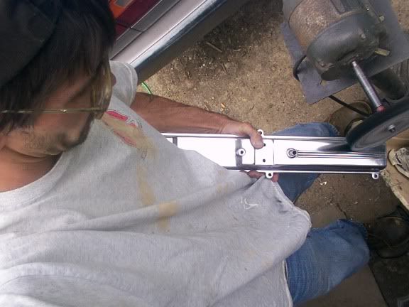

          my is :
          1 1/2 hp single phase 13.8 amp if wired 115 volt ( all you need to do is change a few wires in the box) 6.9 amp wired 230 volts ( that is the setup)

            that is what i got on this motor ... the left side is std siz. the right side is extended

                they are side on ... contact caswell and they can help you out ...
                i have the extened one's on that motor ...
                is kind of a spare ... or when i want to cut my electric bill down i will use it on little stuff
