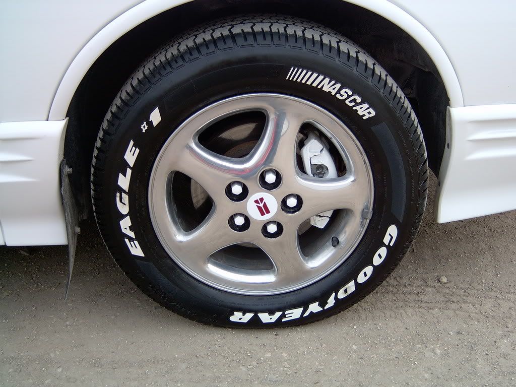

            i did the rims on my 96 cutlass. ONce you get the paint all stripped off they will be a rough cast. I sanded and sanded and sanded some more. Then I used a series of wheels similar to the vented buffing wheels sold here. They are from the Busch company. I stepped down with compound and ended up with this. I painted the holes that i couldn't get the buffer into.

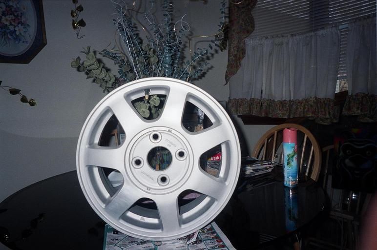

                I bead blasted my rims I think that is the best way if you have access to one

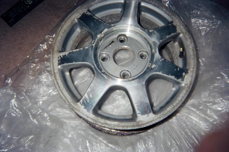

                Here's how it came out

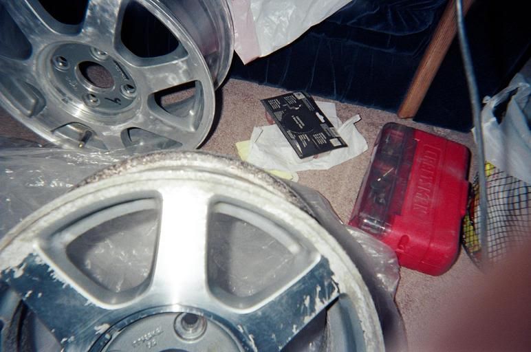

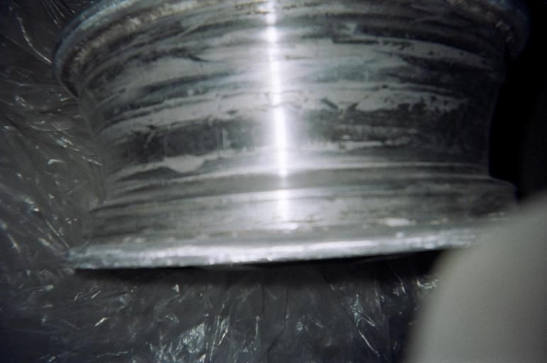

                  I forgot to add that I sanded down all the deep wounds first. I got these wheels from a junkyard and the wheels where buried in 4 inches of mud
                    looks like a good start. keep us posted on the progress

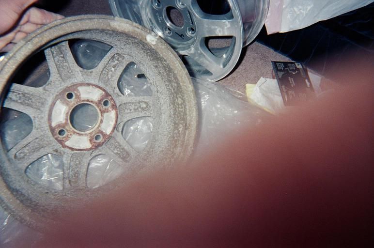

                      Heres what the wheels looked like before
