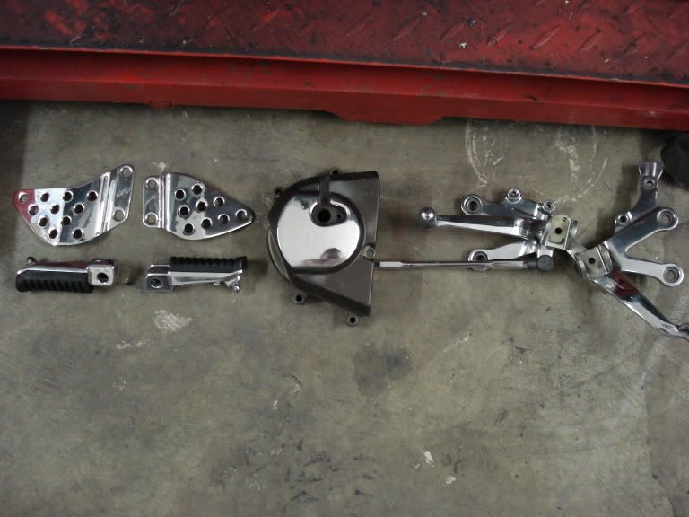

                      not sure about larger objects but here is a magnesium engine cover i did earlier this year:
                      (circle part in the middle is mag)
                      only thing i can say is that tripoli cuts as fast on that stuff as emery does on soft aluminum

                        Looks pretty good. Did the finish last?
                        I'd guess it's like aluminum...a lot of different alloys and they all take a little different method...

                          that mag finish didn't last at all, i won't do any personal mag parts again

                            Well, if you can get them looking good enough then use Zoopseal or powder to cover it, maybe it would be worth it.

                              i got zoop, but was trying to sell the bike immediately and didn't want to waste any of it on that thing
