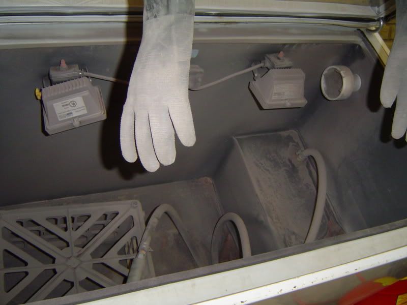

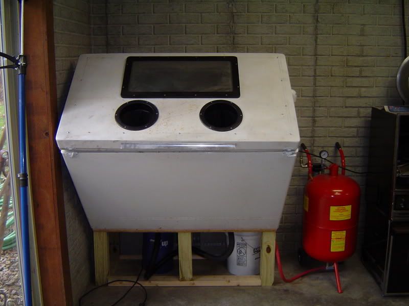

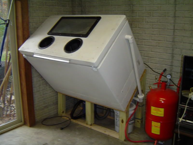

                      Just finished this a couple of weeks ago complete with water filter.
                      Got the freezer for free, (plus it has a metal liner) cost about $40 for the wood and PVC/bucket

                            Bahahahah dude thats awesome, I wish I would of thought of something like this before buying a cabient from harbor freight.
                              Re: sand blasting cabinet...relocated to tips n tricks section
                              thats looks awesome,but how do you reclaim your media
