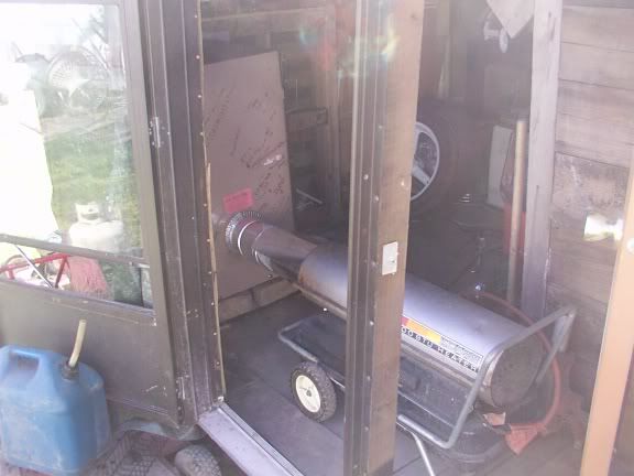

            Build a metal box and get a torpedo heater works great..
            all that box is. it is a steel storage closet i converted it .. heat at 400 in 5 minutes i crack the door to control the heat. door closed tight it go's to 700f in 20 minutes
              Customandsound, How many BTU's is that kerosene heater?
                100k
                  Thanks, also, dimensions on that box?
                    that box there is 24" deep 40" tall 26" wide the only problem i have had is i got the box cherry red on the back side a few times. there is no fiberglass in it either it is straight metal..
                    if you adjust the intake tube you can keep the heat to 400/450 no problem. i built it just to do wheels in.. i have had it at 700 for an hour for ceramic but i would not do much of it in there..
                    i got 3 ovens the biggest being 8'x8'x8' i run 2 200k heaters in it
                    i got another oven 24'long 18'wide and 8' high i need to run some elemnts in it it will be electric and gas .. the gas will get it to the temp i need then the electric will kick in and keep it there...
                    well back to powdering i go .. i got part's in the oven as we speak
                      Awesome, thanks! I just bought a 100k kerosene heater off of ebay for 50 bucks plus 45 shipping. I have a 4 foot long X 2 foot deep X 2 foot wide, 1/8 inch metal box. I figure it's a good start, I will build a bigger one when I start powdering bigger items. Thanks for the help!

                            My lazy initial google search found several 35k btu propane units. Would that be enough for a 3x5x2 box?
                            Thanks
                              yes it should be .... you can pick them heaters up cheap at tool rental places i got the 1 in the pic for 35 bucks
