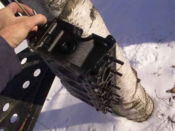

    I have done jug's for a harley in wrinkle black
    my head's for my car in silver
    i never had any problems with the head or jugs at all :
    hight temp powder is only good to 1000f
    regular powder will hold at 799f
    the head put's out 1500f at the pipe on a highly built motor
    But the block intake oil pan ect can be regular powder
    and a cycle can be all regular powder .. any Built motor i would go with the ceramic tech line ..
