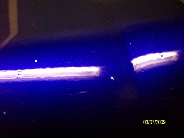

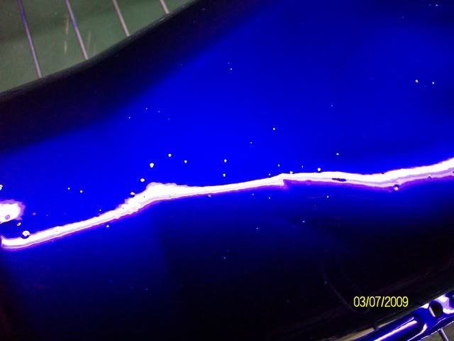

                      I noticed some dirt specs on the finish of a valve cover I did. I disassembled and inspected everything and couldn't find the cause. I'm always careful about keeping my gun clean, probably to the point of overboard. I took the air fitting off my air hose and ran a q tip down into the hose and it came out dark brown. I went out and bought a brand new air hose, a new water separator, moisture separators, and some in line desiccant air dryers. I also cleaned all the fittings and couplers out. I also went one step more and tried again using another compressor. Instead of using my old 220v monster that has some worn rings (oil blowby) I used my dads little 1/2 hp oil less compressor. The following pics are the results. Fisheye everywhere. I didn't spray any silicone anywhere, baked the part at 450 for over an hour, thoroughly blasted the part, wiped it down with acetone until dirt would no longer appear on the rags, and did the water break test, ect. The rags are brand new micro-fiber towels that I cut into pieces and there are no chemicals in the towels. I've used them before with no problems. I applied iron phosphate and rinsed thoroughly before putting the part back in the oven to bake off any residual moisture before applying powder. I can't for the life of me figure out what is causing the fisheye. Here are some pics. Any ideas guys? I hope it's just something I'm overlooking.
                        Re: Helpful Tip : FISH EYES OR WHATEVER
                        Still surface contamination of some sort. It seems as though you have taken steps to eliminate the air supply. Have you cleaned your oven lately? After the outgassing who knows what floats around in there.
                          I clean the oven with a tack rag to pickup the dust and stuff that collects on the top of the oven above the burner elements. I think that when i was using the old air line, it blew oil into the powder in the cup. When I put the left over powder back in the bottle it contaminated the rest of the powder.

                              Well the good part of it is, I used the last of that powder when I did that. The color partial cured with no problems, but the fisheye appeared when the clear started curing. I used the last of both of them on that piece so I just ordered new powder. I'm going to do another test piece with another powder and see what happens. Is there a fisheye eliminator additive?
