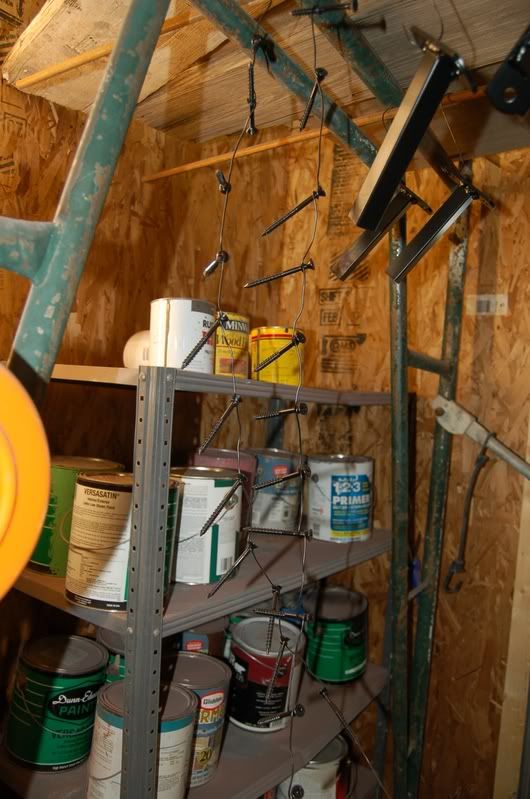

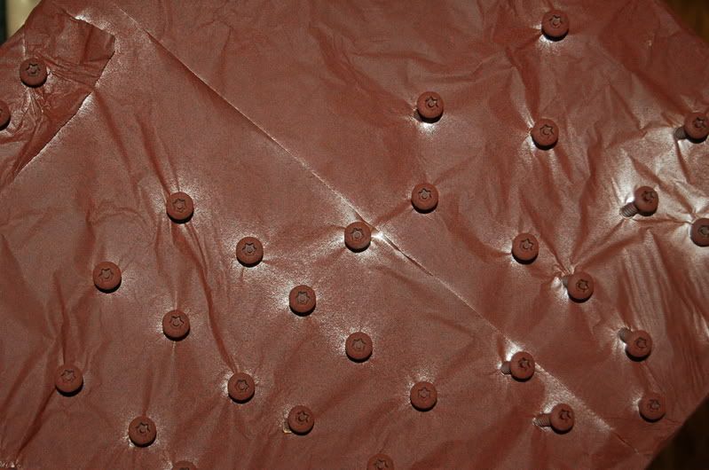

    just a quick tip for those of you interested. When I have to do large sets of fasteners I prepare them like this:
    with a wire
    cardboard & foil

      Do you have problems without grounding them? I just used cardboard.
        Re: Tip of the day! if you're interested....
        Looks like he's stuck the Torx through tinfoil I do them the same way

          Tinfoil should make a nice ground to all the parts, but that's allot of grounded area sucking up powder also it looks like. Have you tried putting the tinfoil on the back side of the cardboard? Looks like it's on the front side to me in the pictures.
          I would think you would get as much ground to the parts but with foil on the backside the parts might grab the powder better, not having the foil ground all around them like that.
          Another neat trick is save your beer and soda cans. For bolts and screws punch holes in the cans a bit smaller than the bolt or screw and screw or press them in. Ground to the can top or pull tab. This keeps the powder off the threads.

            thanks guys . i was using the wire only . the tin foil and cardboard might be better and faster in some cases .never thought about that ,maybe that s why we have these forums

              Would cardboard handle the cure heat?

                Yup thats what we always use. It's just as fast and easy. I've used the pop can idea before as well. Then you can also preheat the fasteners and shoot them hot.
                  no problem with the cardboard bro! & the overspray on the foil is not an issue either. There will be overspray anyway so it's no big deal.

                      and the torx fits well??
