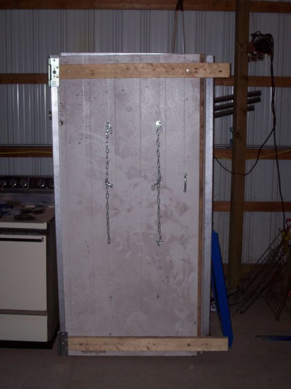

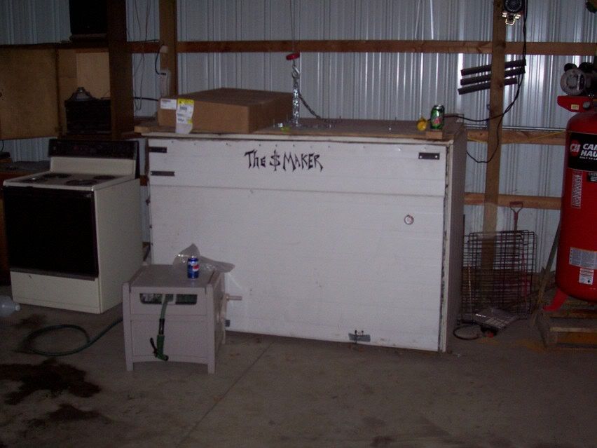

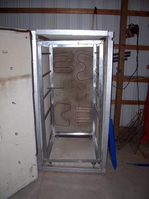

            Heres the pics of the oven.
            It was made out of 2" Insulated sheet metal with a concrete like finish on the inside. Works very nicely and we dont lose very much heat.

                  oven looks good for starters my only concern is the mismatched elements. this may be a concern. generally speaking the shape has to do with the design of the original oven they came from. what i am trying to say here is they may not all be the same wattage/ heat range. if this is the case it could cause hot spots in the oven. example: if they were numbered top to bottom left to right, then lets say that 1 is 500 watts, 2 is 400 watts, 3 is 750 watts, and 4 is 600 watts. there might be a time that parts closer to element 3 cure faster or more than parts next to element 2. this can also cause a issue if you wire them in 2 circuits, the circuits should be balanced if/when possible to insure even current flow through the contactors. in the example of 2 circuits running from a 60 amp supply, it should be 2 30 amp sides and not a 40/20 split. i hope this makes sense. also please dont take offense i think you have done a great job so far. i would wire it up and try it out. if you can get a amp probe to test the circuit draw this will help. also when you fire it up for the first time put some scrap metal in the oven at different locations(preferable the same size and material scrap metal. bring them up to temp and check each part with a laser thermometer to see if you have hot spots. i also lastly would think about a fan for circulation.
                    Re: Wiring Oven
                    Yea, the elements are out of 4 different ovens, never really thought about the different power levels. Also we had a fan in there but it wasnt made for heat and partially melted causing it to wobble. The oven holds the heat very well, the outside is only 10-15 degrees warmer than the air temp of the shop.
                    So is there a place that i can buy 4 new elements? Is 4 elements enough for our oven?
