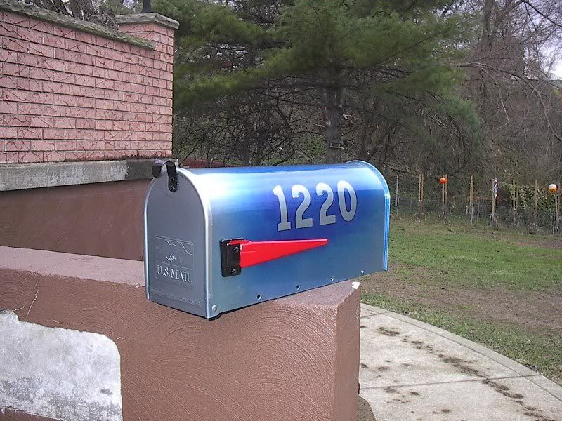

                  Ya man that looks bad cool. Started to play a little myself, my buddy Kirk's got the badest mailbox on the block.

                    very sweet mike. that is a great fade job bro.
